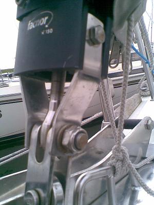

I just bought a smaller sale, because I selden use such a big genua like that. But Menno how did you lower your forstay. Can you make some pictures. Or did you releave the plates of the roller and did you connect your sail to the deck. Or do you mean the long stainless steel plates with holes which connect the roller on the deck?
Indeed I mean the long stainless steel plates with the holes. I made them app. 10cm shorter with new holes on the bottom end. This brings your roller down with app. 10 cm. which gives you he possibility to move up the rail one position (holes are already there in the rail). This also looks much nicer and sails better… (I’ll try to make a picture next Wednesday evening if I don’t forget )Maatskip39712,8783680556
Picture:
Ok? Menno,
I shall look at my 34, but I believe that my roller is already low. Thanks.
Is het like this?
